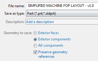

In Beta 2, this will be optional when saving to a Part file
in the form of checkbox shown below. Please give this a try.
