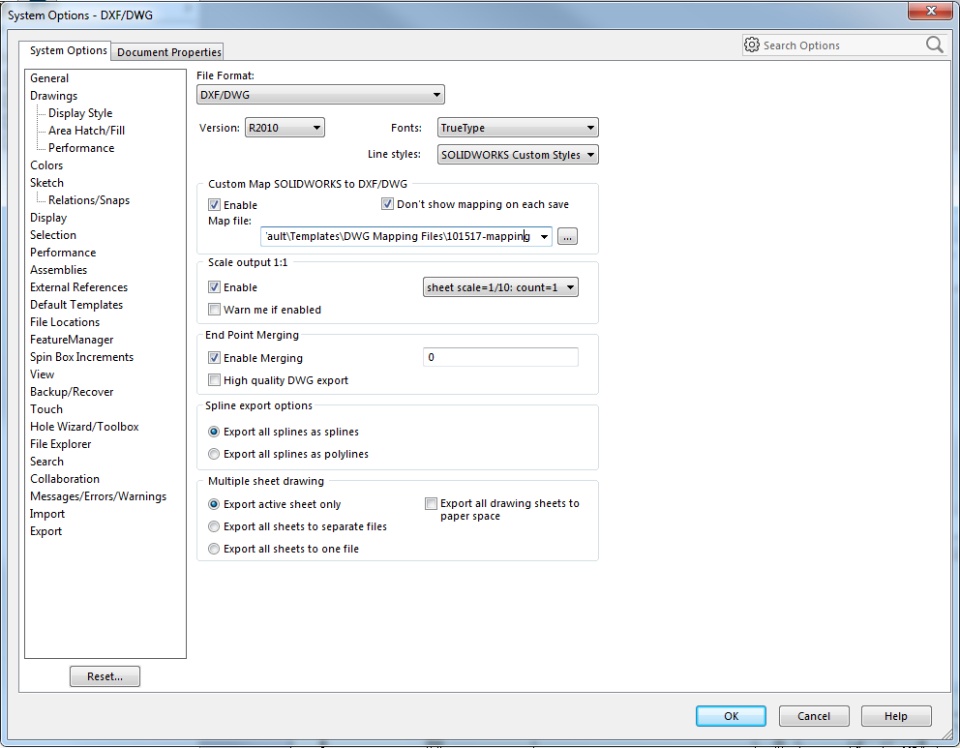

We want to create a new Save as DWG macro so that anyone who uses it, gets the exact same results. It needs to:
1) save to specified folder ("\Desktop\Export\")
2) use a predefined mapping file ("C:\EPDM_Vault\Templates\DWG Mapping Files\101517-mapping")
3) Along with the following settings established.
Below is a sample of an attempt. I'm able to get the file to save to the right location, but I'm baffled on how to specify the mapping file and other specific settings. Can anyone shed some light on this for me?
