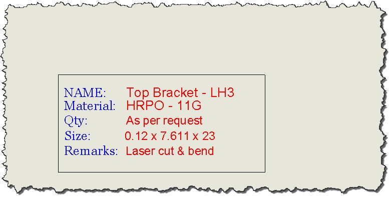

When I save a SolidWorks drawing as DWG or DXF, some of the original font colors from the drawing doesn't export correct
For example: The picture below shows and .sldnotestl (annotation file) inserted into the drawing and the values are populated from the part properties
All the other fonts from the title block exports properly with the same color as the drawing
Is there any settings in the save options can maintain these colors while exporting to DWG/DXF

Hi - try this setting in the save as options
comment imagecomment imagecomment imagecomment image

John,
Thanks for the quick reply
I couldn't find a map file. Is there a default map file anywhere in the install folders I can open and modify
I am not sure how this map file works when export to DWG file

You have to save the Map file, I'm not in the office till morning, though..  I think you should be able find it in the help file.. or check your layers toolbar..

Here's a good thread on the subject:

  - Thanks for picking up my slack this morning - that is a great link and that should be the correct answer for

Thanks to Dan & John,
I tried to map the colors and still unable to get the result.
Anyone tried to export notes from SolidWorks to DWG with the colors?
I will play more with map and see if that works
