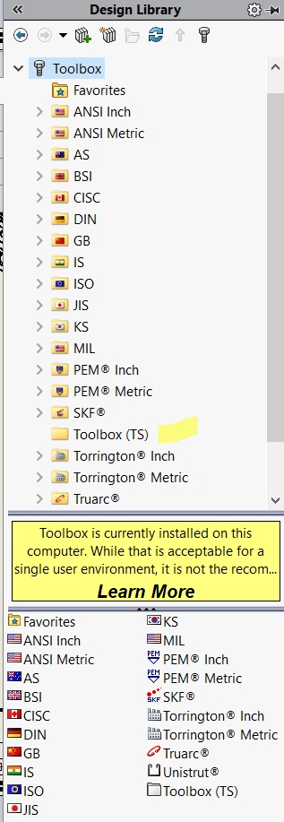

I have added a new folder in my Toolbox (marked in yellow below), including setting custom descriptions for the parts in it. Is there a way I can save only this custom folder on my hard disk. So that every-time I uninstall/install SW I can just point SW to this folder so that it can be added to the standard Toolbox? I do not want to make this folder every time, make changes to their properties etc. for every new installation. Thanks in advance.

I think you can configure your toolbox and change in the user setting "create configuration" to "create parts on ctrl+drag" as shown below. This will let you save your custom toolbox items in certain path in your local which can be recalled later in another installation.

It'll be saved as individual only of you CTRL+DRAG it in your assembly. Otherwise it will remain a Toolbox item

Ashistaru, Thanks.  But it says that an individual part file will be created. I want the part to remain as a toolbox item in my assembly.
