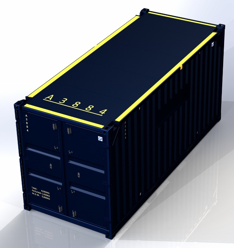

Same Decal, different position, different colours
I've attached a render of my model to show that decals that are the same colour in the png file, and show the same colour in solidworks render as different colours.
I have played with the lights but nothing seems to work. As you can see the lettering and numbers on the front are yellow. but the number on the side is orange. Orange is what it should be.
What's up?
SolidworksPhotoview 360

Benedict,
I think it will the light that is created from your Environment HDR image that is causing the colour change. Try changing your Environment HDR image to see if it makes a difference. Go to "Edit Scene" & it should be on first tab, second section down.
SF
SF 2013-07-26
I changed backgroud to non, and tried various colours and the tope decals stayed yellow.
Then I changed it to 3 point beige HDR and that has sorted it.  Thanks.
Any idea why that could be?
