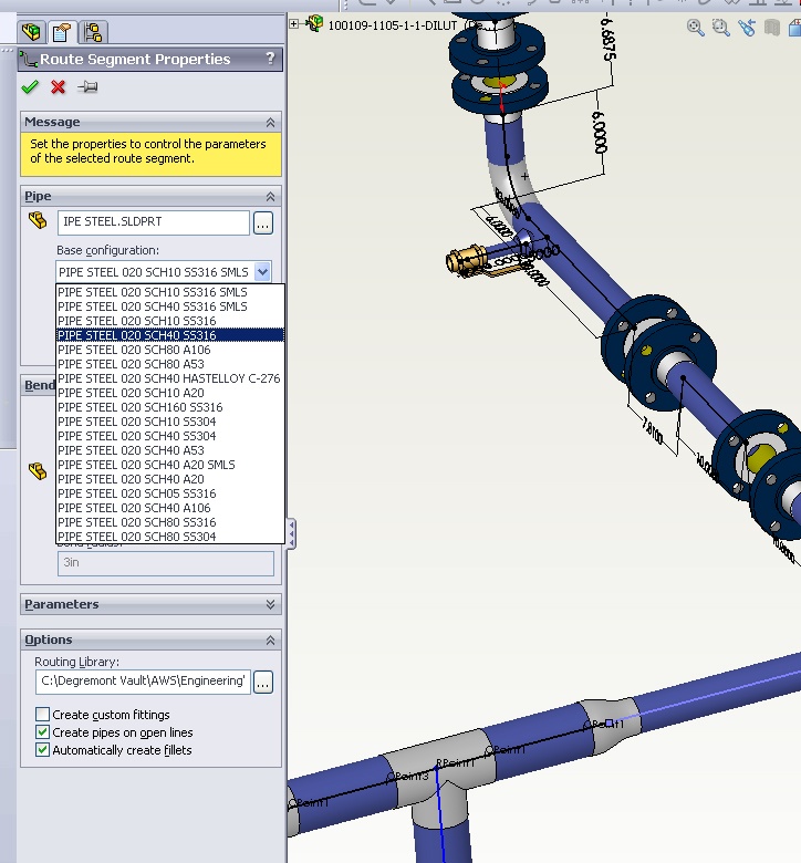

Routing Properties
As I started to route Socket Weld Piping Route. Have properties chosen. For pipe to be 316SSL Sch 40 Welded which takes fourth posistion in pipe configuration listing (pipe-base configuration). For elbow Socket Weld 3000# 316SSL. The routed pipe will not keep given property. Will snap to the top of configuration list picking up seamless pipe sch 10.
I have about 200 pipe sections in one system assembly. Route Segment Property of every piece have to be manually corrected. 200 times.
Is there any way around of this bug?
SolidworksRouting

DP 2010-08-12 Best Answer
It seems that there is a conflict somewhere with the pipe configuration and possibly other route fittings that you may not be able to fix.  Just as a stopgap measure to get you through this project, you might create a separate pipe part for 316 SS Sch 40 in your pipe library where that is the ONLY configuration.  That way Routing cannot default to the pipe type that you do not want.

I would expect that the reason that it reverts to the top of the list schedule is because you have a reducer in the line.
It's a known issue that when the routing Ø changes that the program "forgets" what schedule you were using.
The easy solution is just ignore it and fix it manually in the BOM because less face it, the only time one cares about the inside of the tube is for calculations or simulations. If it's strictly for piping drawings then the main thing is that the outside Ø is correct.
The other solution is to do as David Paulson describes, namely making it so that you use a pipe part that is meant solely for that project or even solely for that route and therefor doesn't have other schedules available.

Peter,
I have new routes started from flange. Very first routed pipe will snap to wrong roperty.

If it's the very first pipe then I have to ask if you have been using that particular flange or pipe before. If not then I would suggest to take a really close look to the design tables because it could be that in that case there's a small difference in a certain number or name that makes it not recognize that Ø in that particular schedule.
When you tried using Route segment property to change it to the schedule wanted were there any issues?
If not then the fault lays elsewhere and the design tables should be fine.
I take it that ignoring what pipe schedule the program use and just change it in the BOM is not an option?

Peter,
Bingo. One configuration had SMLS description. The other one for welded did not have any as this is our default per company spec. Extra description in Pipe Identifier confused routing.
I corrected Pipe configuration name and identifier description by adding ERW for welded pipe. Now the property stays on what I selected at the beginning (Unfortunately it works only for pipe dia selected at the start route).
