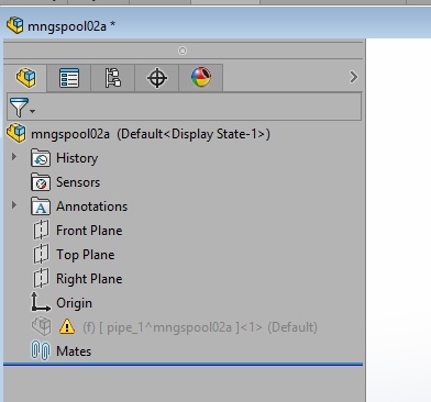

New to routing here.  I have done a pack and go on an existing assembly and now need to make changes on each spool.  Some spools open with no issues and others open like the one below:
Need some assistance to fix the missing location/link.

Hi Miranda,
Did you save all the Pipe Route segments externally?
If not, save all the Pipe Route segments externally and try it again.
And chances are there may be a pipe segment with the same name, that is preventing it to open.

If I perform a Pack and Go on an existing assembly, is it proper procedure to save every internal pipe externally?  Is there an easier way?
RK
RK 2018-02-16
Yes it is. It is always a good procedure to save files externally, otherwise the references will be lost when moved to other PC and also check whether any of the files have the same name. This prevents it from opening properly
