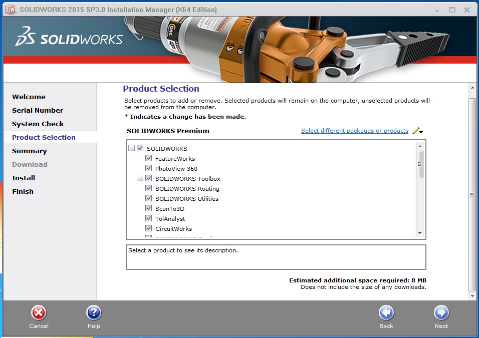

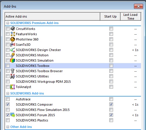

I cannot get the routing add-in to install.  I just did a complete uninstall including registry values and Data files and Folders, and then reinstalled using a new download of 2015 SP3.0. I checked the box for routing on the install options (and verified it after the fact by checking it with the Change option in control panel) and it still will not show up under my add-ins in Solidworks.  I even ran a repair on the installation and it still did not fix the issue.  All of the other optional add-ins seem to be functional.  Any ideas?

Might be a dumb question but do you've serial number for premium or Professional?

It is a (premium) network license key.  The other premium features such as Simulation, TolAnalyst, ScanTo3D, etc loaded without issue...

Was it working in earlier version before you upgraded OR this is a fresh install?
Type routing on Start > Search Program/Files and see if it displays the routing manager?
If nothing helps then please report to your VAR.

This is a fresh install on a new machine, and yes the routing library manager shows up in the start menu and seems to run.

Could be issue with the server or license file. Is this the only machine with error OR are there other machine showing same behavior.
In either case, please contact your VAR.
