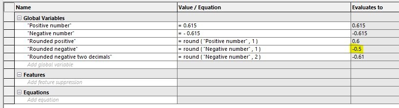

Is there any way to correctly round a negative number to one decimal?
-0,615 rounded down to one decimal should be -0,6, but evaluates to -0,5 in SolidWorks.

Oh dear, it's even worse.
Try this :
Have a positive number 0.64 and round it to the 2 decimal places
I get as result 0.64, which is to be expected.
However when I do the same with -0.64 I get -0.63 even if I do -0.640000 I still get -0.63
Can anyone confirm this?

I get the same result:
comment imagecomment image

By the way, it seems that any number that you round of to the amount of decimal places that the number has will automatically revert to it be smaller. In other words  round ( -0.6 , 1) = -0.5  and ( -0.666 , 3) = -0.665

Hi it didn't work to copy/paste the formula, but I got it to work after i modified it:
"a" = - .615
"b" = if ( "a" < 0 , round ( "a" * - 1 , 1 ) * - 1 , round ( "a" , 1 ) )
It works, but it's an unnecessary workaround.
