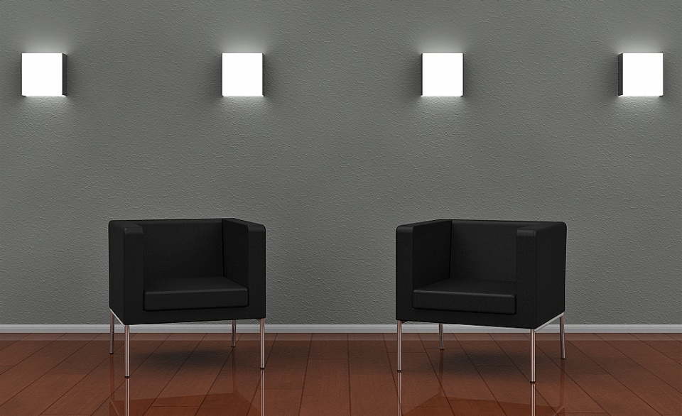

This is what I am after.
The enclosed pic i did last night i would like some light to come in from the side and make it look like its going through a window and casting shadows on the floor.
GH
GH2010-02-26
thanks Paul. i learnt this work-around a while back by mistake. you can get good results from it.
GH
GH2010-02-26
could you post your assembly here so i can have a go?
RR
RR2010-02-26
Paul brings up a good technique.
To do the window shadow effect you'd have to model a wall with a window cut out on the side of your scene (off camera). The using Paul's technique place a light panel (rectangle geometry with the area light appearance) on teh outside of your window. Might work? Not sure how much light and shadow will get cast into the scene?
