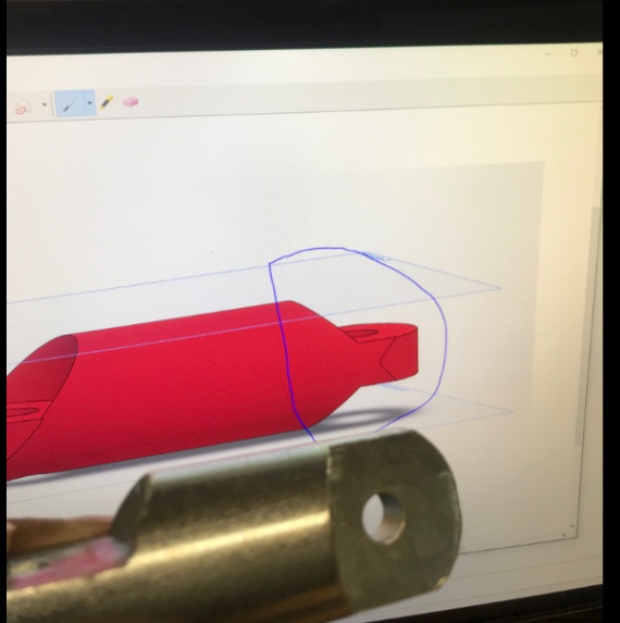

How can I rotate the section in blue 90 degrees? Is there a way I can rotate from the center? See picture below. I've also added the part file.

You could cut the part into 2 pieces and then use the Body Move/Copy/Rotate feature to rotate the body with the blue section 90 degrees around its center axis. Then combine them back into 1 piece.

Simple answer yes.
Split the part into 2 bodies, (make a minimal cut that leaves you with 2 bodies). Move the body with the flat and the whole, fill back in what you cut and you have your part.

Hi Russell,
You can split the part using a plane parallel to the front (or the front plane itself).
Then use move/copy body to rotate about the axis of the part 90* on just the half of the split that needs rotating.
You can then use combine to put back together as one solid body.

At this point the options given by Paul and Alex would probably be the simplest.  Another option would be to edit the sketch planes that created those cuts, choosing one that's perpendicular to the current one.  However, that's going to throw up some sketch errors.  Fixing them might be good practice if you want to try it and aren't in a big hurry.

I agree with this approach.  The way the "correct" answer proposes seems to me like a hack job and will probably add unnecessary complexity to your feature tree.  What I would do is try to change the planes the cuts/holes are on and if that doesn't fix it satisfactorily, then just remake the part.  Good practice anyway, easy part to remake.
