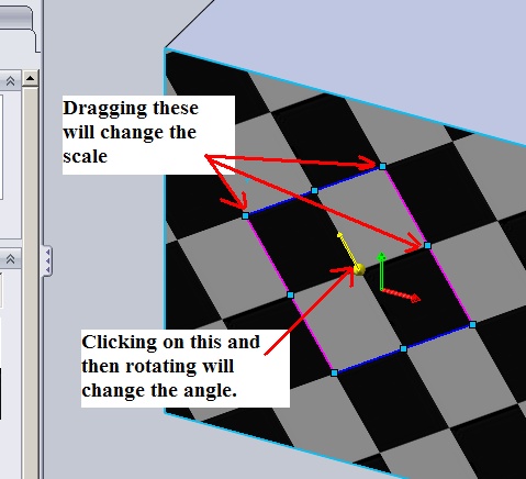

While you are applying a texture to a face/part, use the rectangular box to change scale or angel.

Thanks for the info. Seems like I remember using slider bars in the past to set scale and angle. I have found the angle slider bar, but the one for scale seems to be gone. Sure seems a lot more difficult that it used to be.

I found it to be more handy now. Well its individual's choice as how he/she want to do or need the stuff
