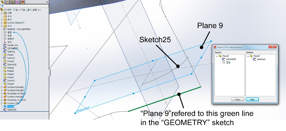

I did 'roll back' and changed 'GEOMETRY'sketch. And then 'roll forward' to end of tree.
But as below picture, 'Plane 9" which refered to green line was not on its position.
I tried to rebuild file, but the plane was not moved
After commanding edit feature 'plane 9', the plane moved on green line.
Because of this problem, I could not modify any feature automatically.
I have to do edit feature for each tree items from revised item.
I would like to know the solution.
Thank you.

First of all, try CTRL Q.
This is a global update and forces everything to rebuild.
Not sure why it didn't update though.

Thank you Mr. Dan,
Force Regeneration command is working.
But when I used 2013 verson, it was not happend.(now 2015)
I should find the way how solidworks do automatical regen..
