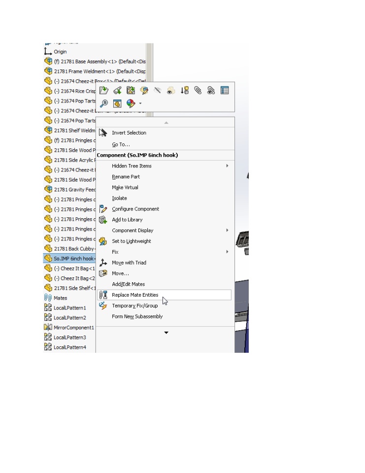

RMB in feature manager tree is missing the replace component option
We recently upgraded to SW2018 and i just noticed that the "replace component" option in the feature manager tree of an assembly is missing. This appears to be an isolated issue because one of my colleagues does not have the same issue on his computer. See attached image for reference. any help would be greatly appreciated on fixing this problem. Thanks

If you click on the down arrow (triangle) at the bottom it will show you all the stuff.  If you want it to be in that view all the time, select the customize button and select it there.
