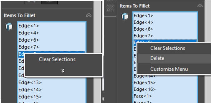

Right Click/Delete Extra Step in SW 2019
Right click item -> delete. Easy!
Not anymore. The box that pops up now has a down arrow that increases the clickable options from one to a whopping three.
I end up clicking clear selections by accident more frequently now instead of delete because of this.
Is this super frustrating to just me? Is there any way to fix this so that the un-collapsed option box appears automatically?

If you click on "customize menu", are you able to put a check in the box next to "delete"? If so, does that eliminate the extra click for you going forward?

yes- thank you kindly.

perfect- easier fix than I thought. Thanks!

Yes there is.  There are two different ways you can fix this.
Way # 1 (and probably the best way):
Select Customize menu from the drop down list and then check "delete"  This will make sure that it is there by default.
Way # 2 (and the reason that the little down arrow is there at all):
GO to Tools--> Customize Then select the "Customization" tab.
Under Menu Customization, select Show all.  However....if you do it this way, then all menus will have all possible items listed.  Making some of your menus unbearably long.
