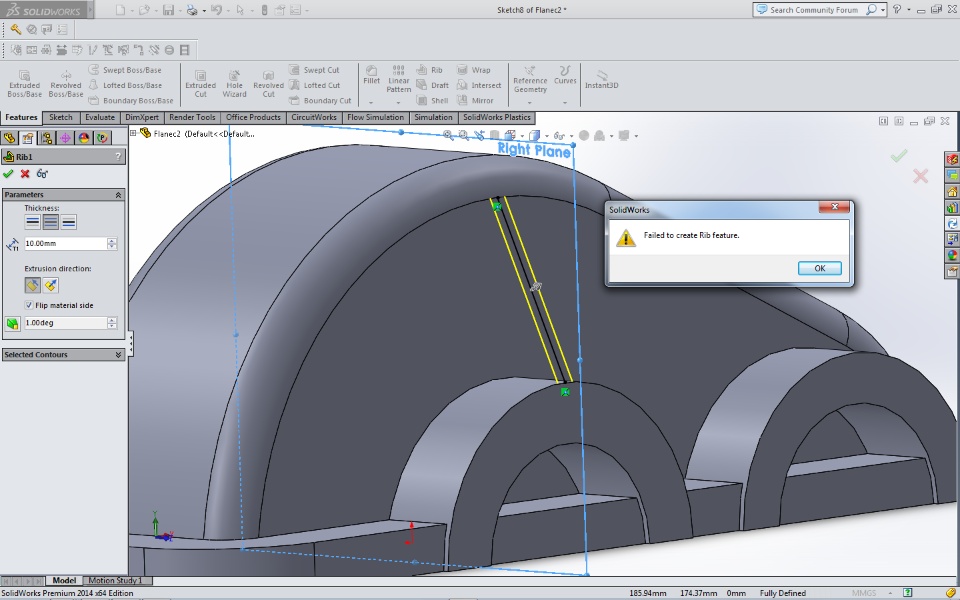

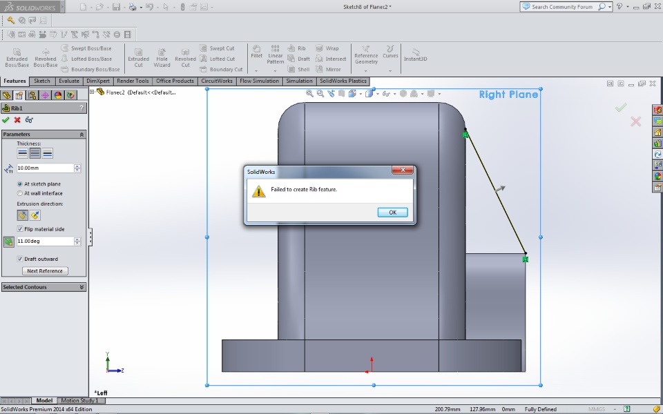

Why am I not able to add this rib feature to this part?
Add lines to each end.
and flip material side.
Hi Delcho,
For creating Rib feature, the sketch needs to be intersect with the model. But in your case, it didn't get intersect with the model. I agree with Mr.Ingvar. Just try the steps provided by him. It works.

finally!!! thank you very much
