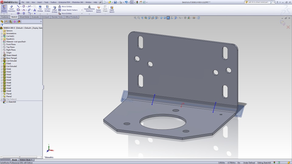

How would one create a rib on a sheetmetal bend? I'm guessing it would be with a forming tool but i can't get my planes right.

I'm trying to add a rib/form on the bend for strengthening.

you bet, I uploaded it.

Great, now can you explain how to fix this?
my part is 0.10" thk what will I have to make the bend radius for it to work.
It's exactly what I'm looking for though.
Thanks.
What do you make the stop plane on this forming tool? I created one based off of your part but still can't get that radius error to work.

What am I missing here? is it my stop face or something.
This is what I get so far
