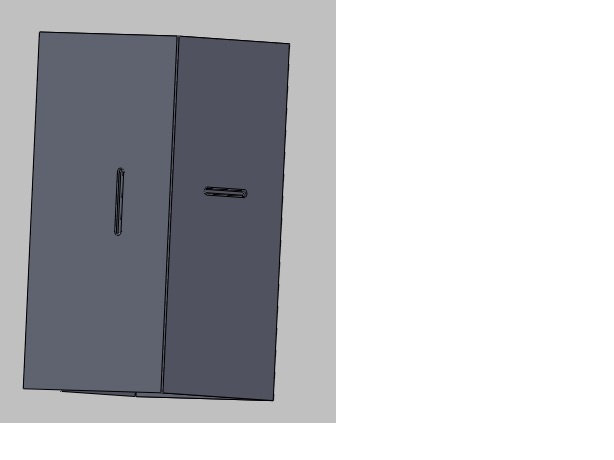

when i insert the rib from forming tool .ftp file , it is rotated at 90, when changing the plane.
is it any command so that controlling of rotation can be constrained.
see the attach image.

After you place the rib, use Modify Sketch (Tools> Sketch Tools >Modify) to rotate the forming tool sketch.
