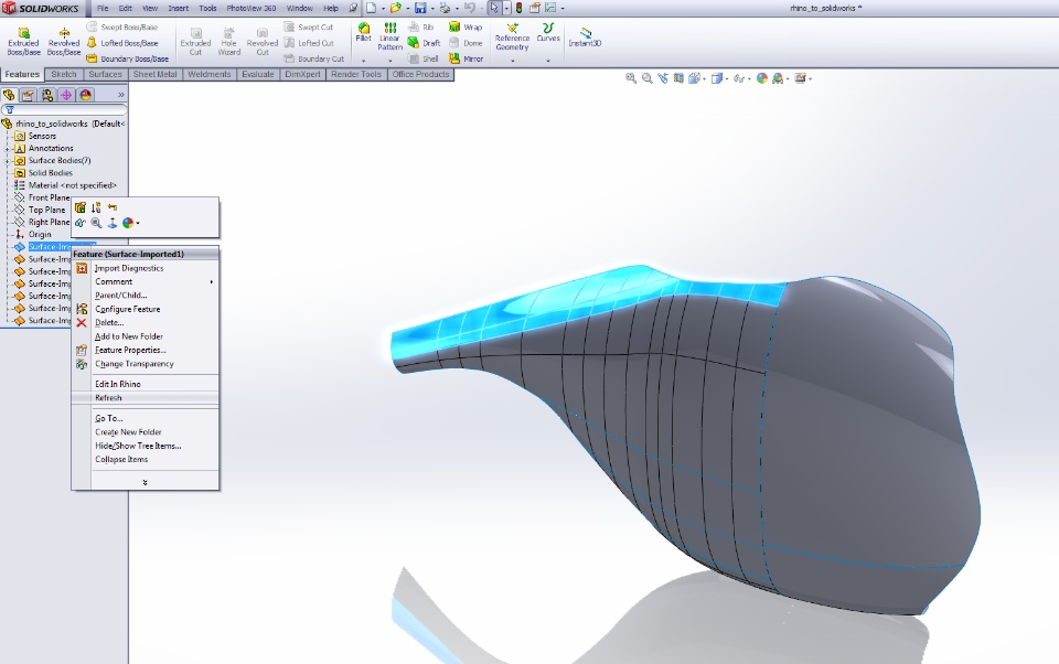

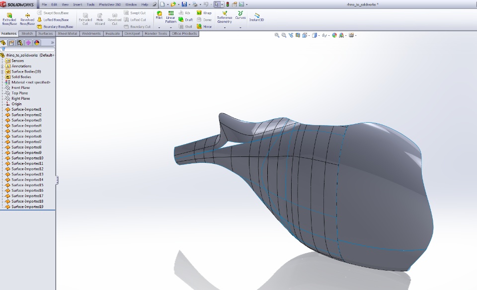

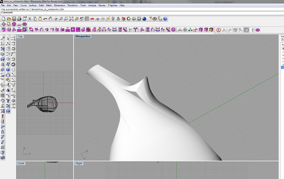

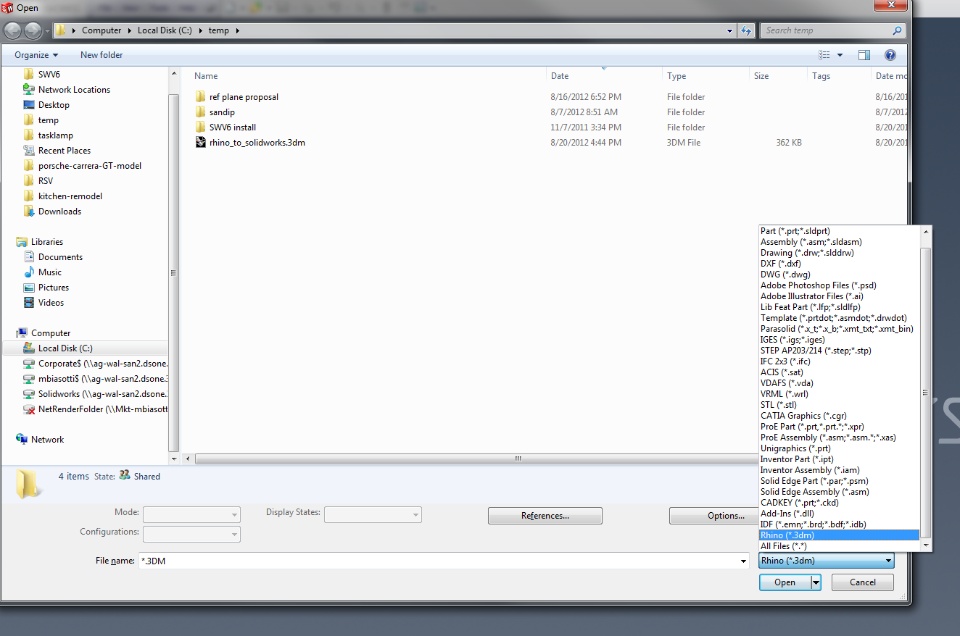

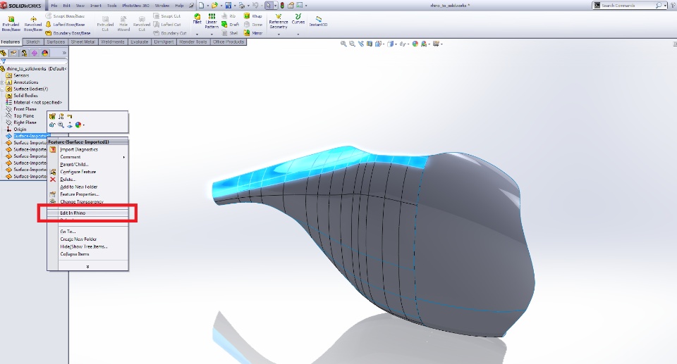

SF
SF 2012-08-21
Hi Legt,
1) (Figure 1) open .3dm file in SW using the .3dm filetype
2) (Figure 2) RMB on surface from Rhino and click "Edit in Rhino"  (requires Rhino installed on same machine)
3) (Figure 3) make edit to surface in Rhino (or any surface that was imported to SW)
4) Click Save button in Rhino
5) (Figure 4) Go back to SW in session and RMB on surface and click "Refresh"
6) (Figure 5) Surface and FeatureManager updated with new change in surface made in Rhino
