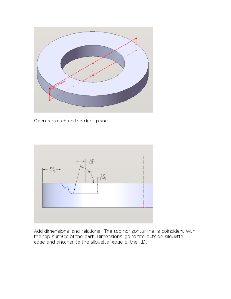

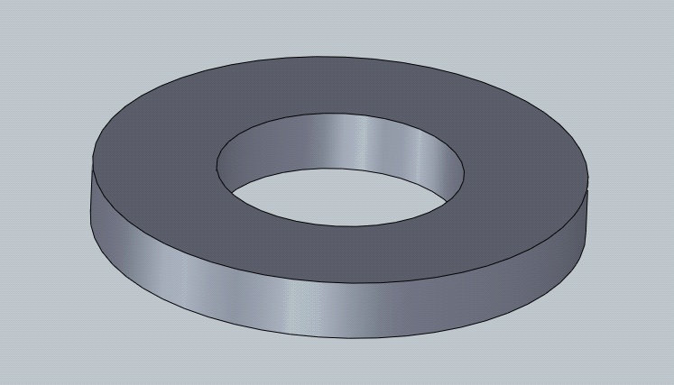

I've run into several cases where I've needed to perform a revolved cut on a part which has no plane on which to sketch.  I've been successful in creating a plane which bisects the part and can sketch on the plane, but I can not reference any part of the bisected part, so it is difficult to accurately create the profile to be revolved.  For example, if I have the following part:
and I want to put an irregular groove in the top surface.  I'd like to do this by creating the profile of the groove on a plane that bisects the part and then revolving in around the central axis.  Is this possible?  Again, I can get the plane, but I can't reference any of the geometry in the existing part.

Yes, you will probably have trouble referencing the part. One way to do this is to create a split line (Insert>Curves>Split Line) after making the plane, but prior to making the sketch. use the "intersection" option, selecting the plane as the tool, and the surface of the part as the splitting body. Then you will be able to select that split line edge in the sketch.
Another solution would be to create reference geometry that snaps to the "corners" of that bisected part. You can typically select the edge of the body, and the endpoint of the line, and get it to let you create a "Pierce" constraint. This way you should be able to recreate a "box" for the bisected part, then covert the lines to reference geometry (or just create whatever you need, it does not have to be the whole box).

Powell,
I have recreated something on the attachment. It worked for me. I'm not sure if you are actually cutting a section prior to trying to make your sketch, but I’ve found that if you section the view for display purposes, you cannot select the sectioned edges. You are better off using a hidden lines view while creating your sketch. Take a look and see if this applies to your problem.
Rich

Thanks Rich,
That is exactly what I was trying to do.  Perhaps I did do the sectioned view - I can't recall now, but I was not able to select any of the geometry.  The problem is that without being able to see the section view, I can't pick the geometry needed.  Take a more complex example such as this:
and imagine that you want to put a groove with the profile you drew on the recessed plane between the o-ring groove and the step.  If I select a plane that bisects and try to draw in it w/o doing the section view, all I can see is the rectanglar side view.  I just tried doing the hidden view trick instead of the section view, but once I selected a sketch element (circle, line, etc) I was unable to pick off any thing.

Nicely done Rich!
I like working in section views so I've found other ways of selecting the edges I want:
I was also able to use the polygon sketch tool and it snaps right to the edge as well.
