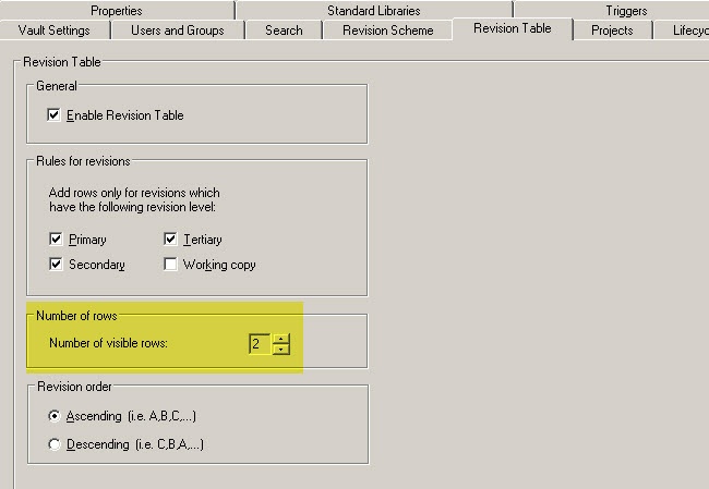

JH 2010-08-02
Here's how PDM Workgroup allows handling the number of revs shown.
