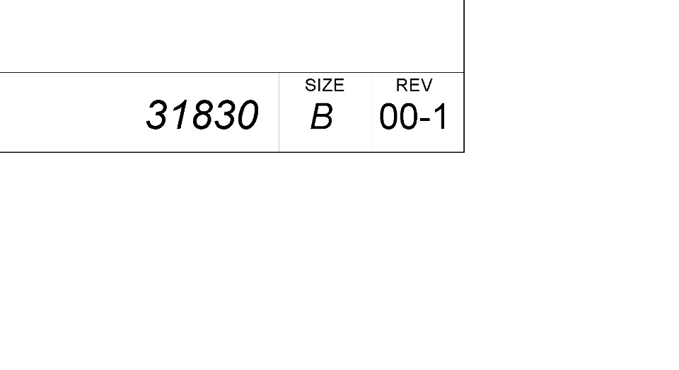

Is there a way to not show the "dash" revision in the title block?  We will check in/out a drawing multiple times and every time it will change it.  Ex: original check in it will show "00-1".  Check out then and check in, it will show "00-2"  I would like it to just show "00" or "01", not with the dash.

The simple answer is no.
However, I was able to create a workaround though.
Here are the steps:
  1. In the model create an equation in the global variable section: "Modified Rev" = left("Revision",2)
  2. In the Custom Properties of the model, create a new property "Modified Revision" and set it equal to "Modified Rev".
  3. In the drawing document's sheet format, set the field of the revision to the newly created "Modified Revision" property.
