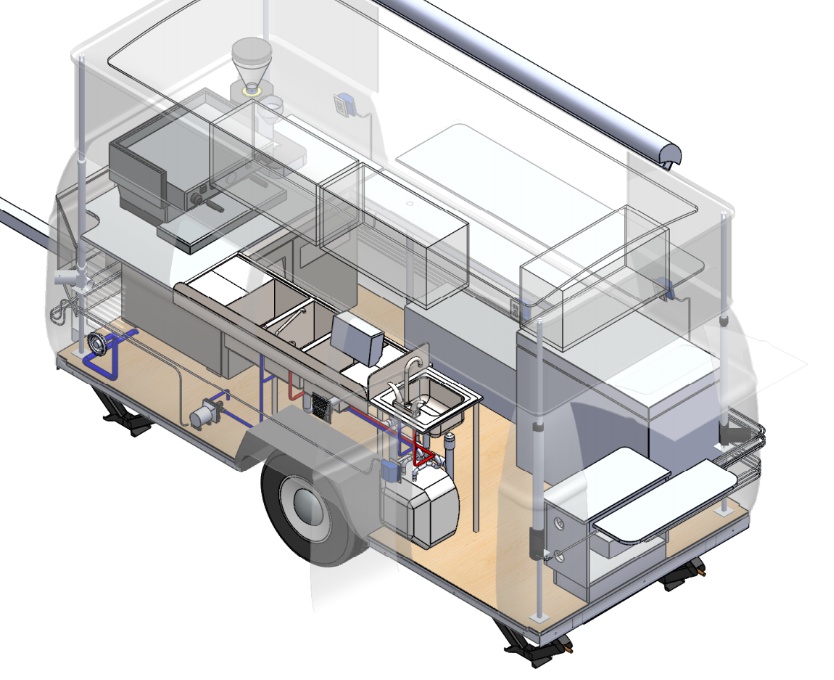

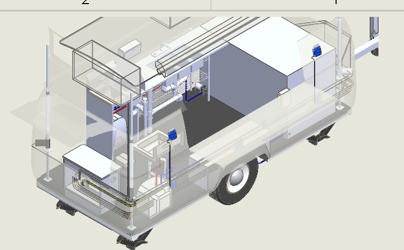

Reverse/Backwards Isometric View
What is the easiest way to flip an isometric view so that it faces the other way? My current view is the first image and I need to align it so that the view is from the angle in the second image.

You can also spin the view to whatever viewpoint looks the way you want and then save that view.  Search for Creating a Custom View in Help.
TG
TG 2017-06-13
Shift+Arrow rotates view 90º.
Start at Iso View, CTRL+7.
Hold Shift. Hit Left. Hit Left. Hit Down. Done.
Except, now it seems to be looking down more than it was. Not an ideal solution, but fast and dirty.
From there, you can use View Cube to align it better.
As ​ suggested, then save view if desired. I also do that for any Assembly in which its primary Iso view is not ideal to illustrate what's going on, so that I can recall it on a drawing view.
That said, non-ideal results is why ​'s tool is a superior solution for what ought to be a UI enhancement.

Looks like you want the view on a drawing (as opposed to in the part).
I put some temporary views off to the side of the paper (front, back, left, right) and then go to view layout>projected view and select a different drawing view and move the mouse to get on of the 4 isometric views.
When I get the one that looks right, I hold Ctrl and place the view. Then delete all the "extra" views I don't need.

I agree with ​ that it appears you want a drawing view.  Create a new view in your model (with it oriented like in your second screenshot), and reference it in your drawing.  See #17 at for instructions.

I figured out a couple ways to make it happen, thanks everyone!

you can also RMB on a view in the drawing and pick 3D Drawing View (the circled icon).  From here you can freely rotate the view or select a different standard view.  You can even save the view (floppy disk icon) or just hit the green check to use the new view.  This is SOOO handy.

...or click on the same icon in the heads-up area with the drawing view selected.
