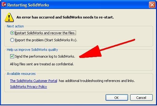

Anyone else familier with this dialog box? I see it far too often during the course of my day. Check out the attached image. See that big red arrow there? Does this performance log REALLY go to Solidworks? Or it is just a check box to make the end user feel some sort of complacence? If it is really going to Solidworks, who is viewing it? Because whomever is viewing mine ought to be about as peeved as i am of seeing it.
I've tried to repeat the steps leading up to a shutdown of Solidworks but I can't seem to replicate it (using Rx).
Fortunatly I've gotten really good at hitting the save button at every turn so at least I'm not losing work but it sure is inconvienient and frustrating.

The performance log referred to by your red arrow is normally sent on a regularly scheduled basis to SWorks if that option is turned on. It does not need to be triggered by a "problem". I hope that it is also triggered when a problem occurs like you are experiencing. I agree that there must be a very large threshold to trigger actions based on problems. I also wish that the threshold were a LOT lower.

Hi Scott,
As you are aware, the dialog you show comes up when SolidWorks crashes.  If you keep the “Send the performance log to SolidWorks” option checked, it will send your log file to us.  We absolutely use this data and we pay close attention to how many customers are seeing a given problem.  This information helps us immensely in reproducing and fixing issues that you guys are seeing, so we strongly encourage all of you to send this info when a crash occurs.
We also get a constant stream of data from the "Performance Feedback" option.  This option is enabled at the end of installation or using the checkbox in "Tools-Options-General-Enable Performance Feedback".  The "Performance Feedback" option will send us your session info on a regular basis, including each time you crash.  If you are opted into this program, you will not see the “Send the performance log to SolidWorks” checkbox in the dialog when you crash because the log file is automatically sent to us.  In this case, the dialog simply allows you to restart SolidWorks or it will allow you to start up sldRx to reproduce a specific issue for reporting to your reseller.
Note that opting in to the "Performance Feedback" program can often help us troubleshoot the more random cases because we get log information when you don’t crash too.   Additionally, each log file sent to us gives us trend information with regard to successful operations, as well as, issues and crashes you may be seeing.  When issues occur, you can work through your reseller and it will allow us to look at the history of issues that you’ve been logging and help us work toward a solution.
If you are seeing consistent crashing or hanging, the best course of action is to enable the "Performance Feedback" option.  Once you have experienced a set of crashes, you can contact your reseller and they can give our Tech Support group your serial number.  We can then look at your log files that were automatically sent under the "performance feedback" program (and from any SldRx sessions).  The log files will help us in our attempt to debug the crash case(s) to come up with a solution, or to let you know if a fix was already included in an earlier Service Pack.  Note, if you cannot reproduce a crash using sldRx, know that the “performance log” file described under the two scenarios above does have your crash data in it, so it is valuable to send that data when prompted, or to opt in to the “performance feedback” program.  SldRx is meant as a tool for system diagnostics and for reporting a specific reproducible issue to your reseller, who in turn will work with us on a solution.
One last comment… the “performance feedback” program is our best way of keeping an eye open for new issues and stability trends that you guys are seeing in your day-to-day work, so we encourage everyone to turn it on.

FWIW, I fired up SWRx and went to the Diagnostics tab and lo and behold the driver for my video card was not up to date. So I've updated the video card driver and rebooted and I still seem to be ok. I'm going to try a few other things to see if I can replicate the issue but I'm hopeing it was just a vid card problem.
