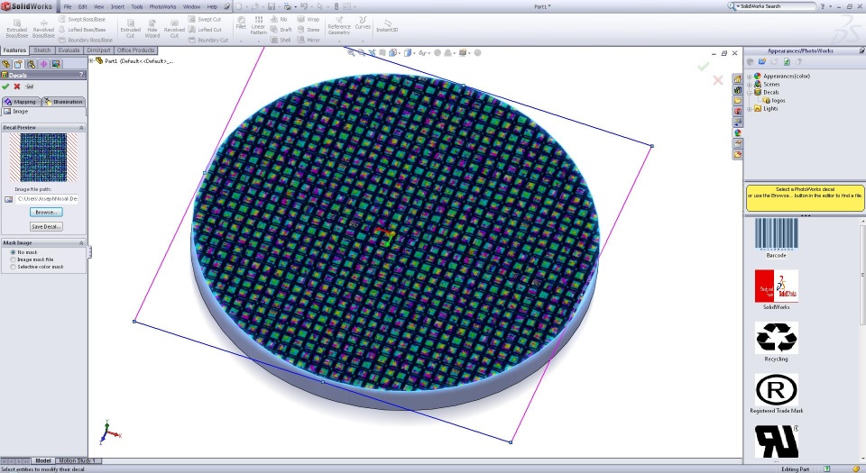

I need to make a model (1mm thick by ØX disc) of a woven wire mesh. I don't want to do it with modeling/patterns for file size and processing power issues. I could put the "chain link" texture but that is not what I am specifying in my assembly, I am specifying woven wire mesh and therfore it doesn't carry down to a spec control drawing very well. Any way to create a custom see through texture of woven mesh?
There are tons of images that are perfect for me to use, what is the specific process of taking an image such as the file attached and making it into a texture in Solidworks that will be "see through" in the opening like the "chain link"?

At nay rate, I tried using decal (creating a custom from an image file with an alpha channel and I get the same result. See attached.
Does anyone have a setp by step process that works for them to create a see through texture similar to chain link fence or perforated plastic.
Specifically, I am trying to make a model of wire mesh as pictured in the first post and patterning hundreds of wires in SWx is terrible.

Joseph
Use your wire mesh image as the decal and use a masking file (black and white image) to control the transparent areas (the holes).  Set your geometry to a transparent appearance (clear glass, clear plastic, etc).  Set your decal to use a different illuminaiton type (plastic would work).  This should give you the transparent wire mesh you're after however it probably won't be perfect.  There should be information of creating decals in the help files.

SF 2010-09-21
Thank you very much for the additional ionfo. I did discover the mask feature last night in my quest. I will use that for the model and renderings in PW.
I stumbled on another problem which makes this kind fo useless. The view on the 2D would have to be shaded to even see this in the drawing so again SW is limiting the options and I need to come up with something to now dimension those wire diameters and gaps.
As I said, thanks again, I'll use the solutions when I can and try to figure out something else for modeling a wire mesh screen thats very large in size.
