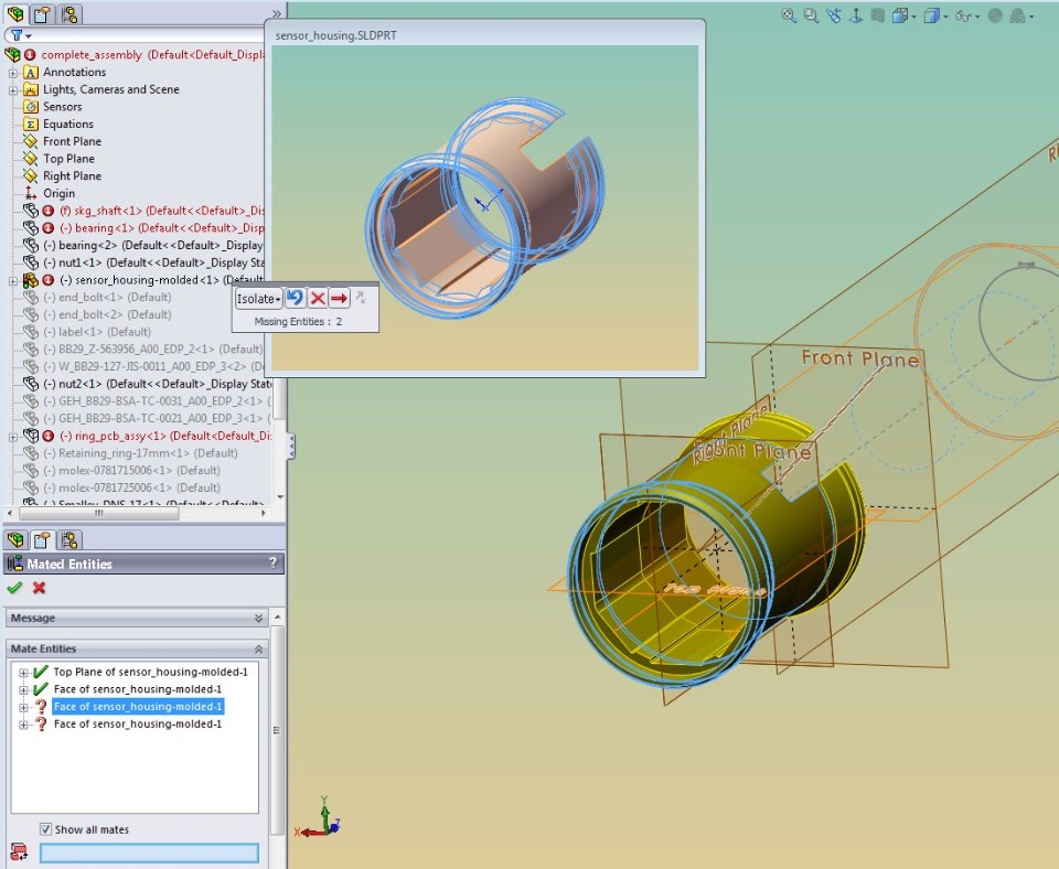

Replacing components and reapplying mates in 2010!
Oh thank you, THANK you for this!
Better than the mid-plane if you ask me.
AFAIK this is new in 2010, with the pop-up window of the part being replaced. Didn't see this in 2009 at any rate. And to think I was just about to add this to the Top10 List.
