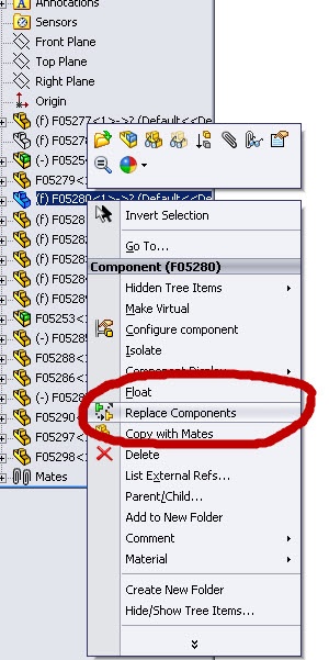

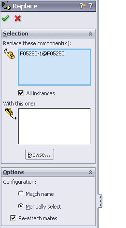

Replacing a component is pretty straight forward. In the assy feature tree, right click the item you want to replace and a dialog box will open. "Replace component" is not in the list that comes up by default so you need to expand the dialog box with the arrow at the bottom. After clicking "replace component" you will be able to select the part you are going to use as the replacement and whether you want all instances of the part to be replaced in the open assy.

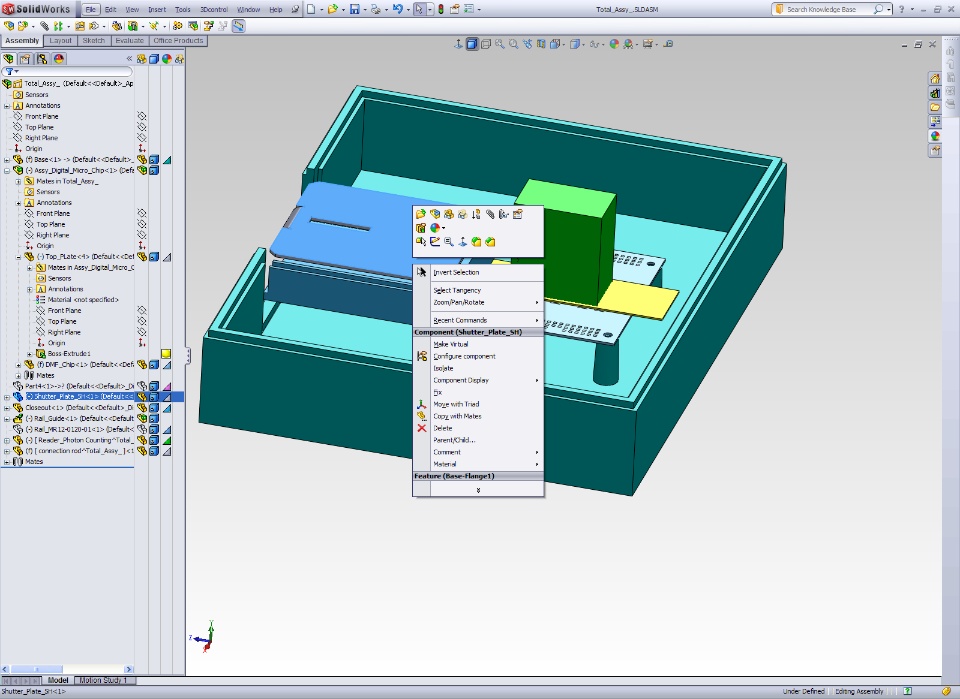

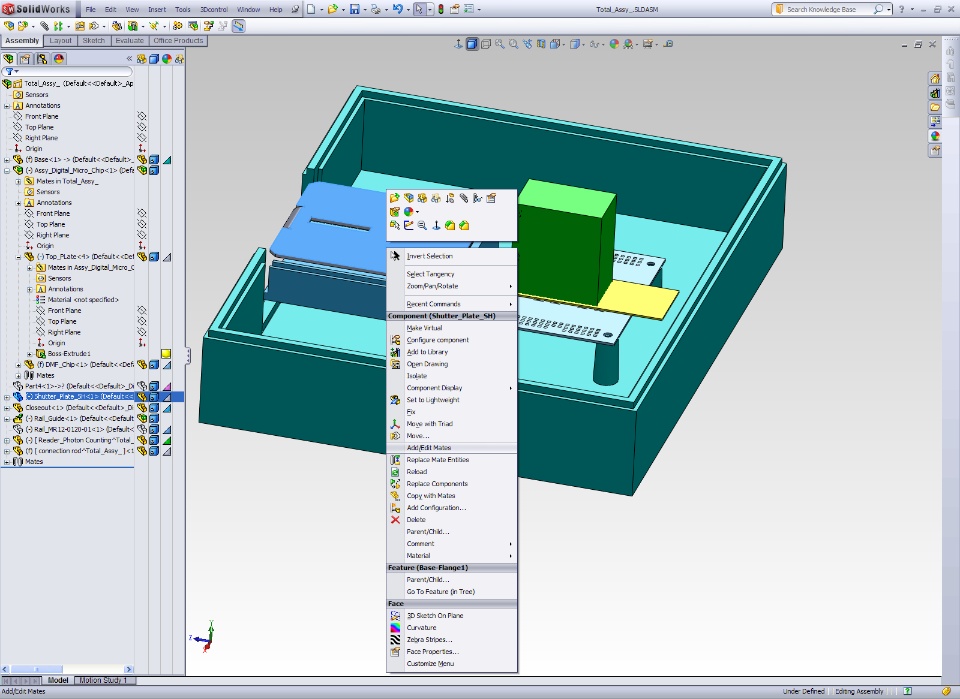

I couldn't find the replace command until I expanded my drop down menu. If you look at the first picture it does not show the replace component but the second one does after I expanded the menu using the arrow. That was my problem thus I had to ask. Like I said in my suggestion for a command finder - I would have just typed Replace Component in NX and it would find the command and also show me the location. I really think all new users should vote for this.
