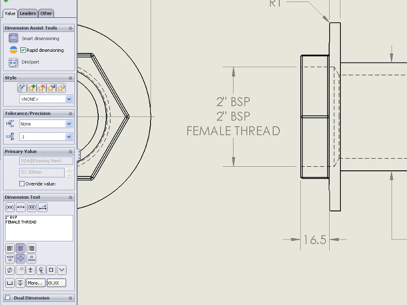

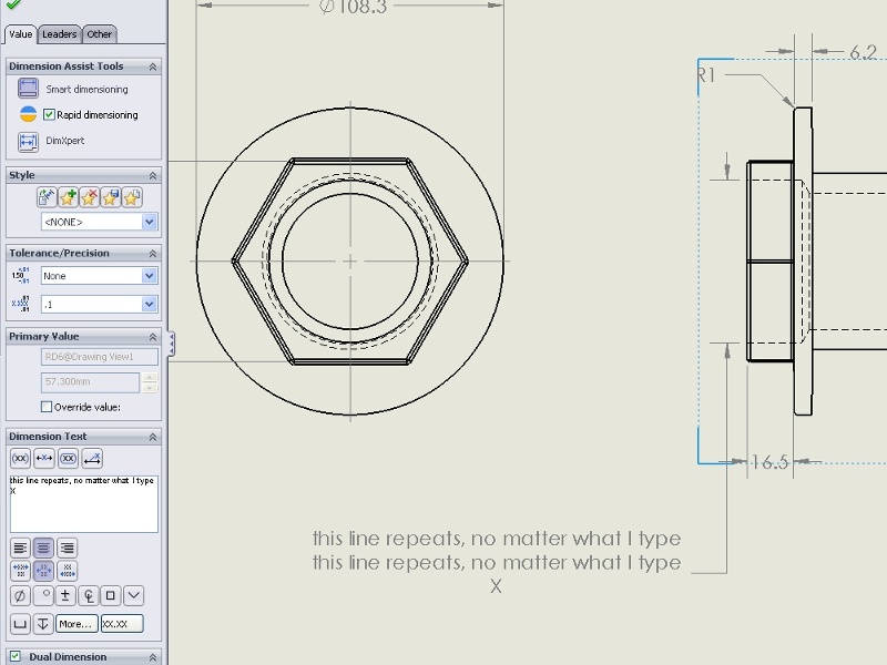

Has anyone seen this before? It never happened in any earlier versions of solidworks. If I enter text into the dimension box (which I have done 1000's of times before) and hit enter to do a new line, it repeats my first line on the sheet but not in the dimension text box.

Another example

Yes, several SPRs refer to it but primarily 556158.  Supposedly fixed in 2010 SP5.0 which is in EV right now.

Then quite possibly in 2011 SP1 which is also in EV right now.

I have the same issue in SW2011 and I experienced it in SW2010.
It only seems to happen with Hole Callout (as opposed to plain diameter callouts) dimensions and when dimensioning a hole from the side view (like your first JPG). This morning I tried to use the Hole Callout feature and experienced the repeating text issue as I edited it. I deleted that and used a regular diameter dimension callout, since I was editing it anyway, and that worked.
This isn't something I have a problem with a lot but it is annoying.
