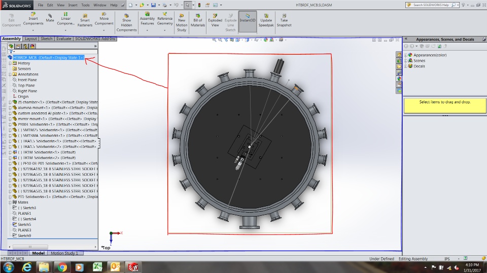

Quick question (I hope) in regards to rendering in PhotoView (SW 2015 x64).  I want my rendering to be defined by the box that encloses my entire assembly, roughly outlined in red in the attached snip.  The default is to render the entire SW view, roughly outlined in blue in the attached snip.  I'd like to be able to automatically render everything inside the box that encloses my entire assembly, rather than using the render region to enclose the model in the particular view being used.  Is this possible?  From there I hope to be able to control resolution of the rendering with the output image size, but I'm not quite sure how to define the render region in this manner.  Any help would be much appreciated!

..well, you could always setup a camera?

Paul is correct.  Camera is the way to go.
You can set the output resolution in PhotoView options.

Thanks guys.  Take it easy on me..I'm a materials scientist/engineer and I usually just use SW to design custom parts for various materials synthesis reactors..this is my first introduction to rendering.  At least I learned the ins-and-outs of PhotoView after spending so much time in there looking for what I now know is a camera..  Thanks again!

Michael,.. cameras are simply great for saved views as well..

That's what I'm thinking I'm not even sure if I need a rendering now that I know about this camera feature.  Really much appreciated!
