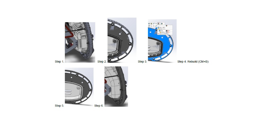

Rendering needs refreshing each time I open a part or assembly
Each time I open and assembly or part I have to rebuild the part so that the rendering isn't patchy.
To overcome this I have to open the part and carry out the Rebuild command on it then save it, but even after it has been saved the same poor appearance returns next time I open it.

 - Patchy = Issues With Graphics Card
ID
ID 2021-04-09
But this rendering doesn't occur on all assemblies.
And it is resolved by using the Rebuild button (Ctrl+B) on the item showing the issue.
Please see the image I uploaded.
