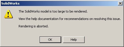

Render error msg
Hello
I am trying to do the Photoworks tutorial of the 2009 version.
In the very first step, when I click the Render button I get this error msg:
I tried to click the Help button, but no help poped up.
I have only 960 MB of RAM in my computer. Will upgrading it to 2 GB help?

SF 2009-10-20 Best Answer
Probably. According to the help documentation, more ram is better.

GH 2009-10-20
you need more ram.
360 uses a lot of memory.

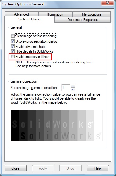

CW
CW 2009-10-21
Hi Elisha,
If you get that error you should check the setting in the options. "Enable Memory Settings" works fine for me.
Greets, Carsten
