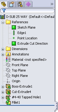

Hi,
  I would like to rename the references in a library part I'm creating.  This is really just for ease of use, I have been able to change them in the past but I'm having difficulties now.  Even in this drawing I am able to rename the "Sketch Plane" and the "Point Location" but I can't rename the "Extrude Cut Direction" or the "Edge1."  This library part was copied from another part and that's where the custom names come from but now the two I mentioned can't be renamed.

Deepak,
  That doesn't work either, it lets me type it in and then when I click away it changes back.
I attached the file if any of you have a chance to check it out.
Thanks!

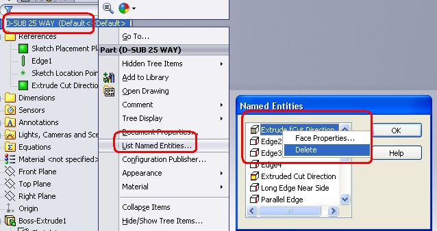

That was not happening because you have tried to rename them several time or selected so many time that list piled up. Delete all of them and then you can rename easily. You'll have to delete one by one.
Open the library part/feature and right click on the name. Then select named entities from the list. The named entities window will appear and you can delete by right click on the name and select delete.
