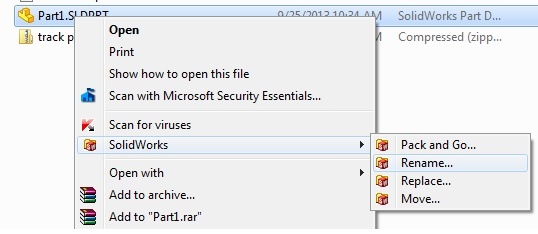

Hello Everyone,
Can we rename the file by DM API.(using window explorer,Please refer image)
Thanks
Yes, you can do this. Use this method: SwDMApplication::MoveDocument. You can also update the children references if the file is assembly or drawing.
