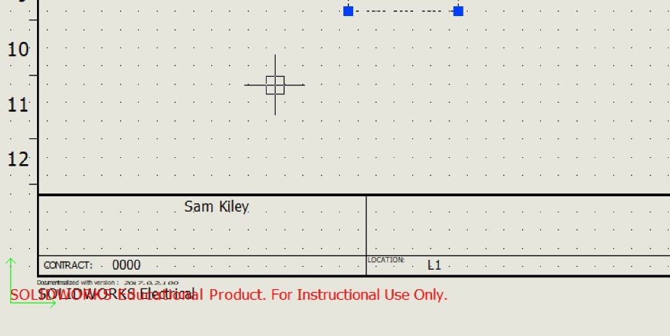

Removing the Solidworks Electrical "For instructional Use only" Red label?
I'm pretty sure I have the students edition of solidworks, so I'm not sure why this would be here, and seemingly not removable.

<p>Samuel Kiley wrote:</p><p></p><p></p><p>I'm pretty sure I have the students edition of solidworks, so I'm not sure why this would be here, and seemingly not removable. </p>
If you DO have the student edition, then there is no way to remove that watermark.  It is there on purpose.
https://www.javelin-tech.com/blog/2015/07/watermark-indicates-solidworks-files-educational-version/
Did you mean that you "don't" have the student edition?  If you DON'T have the student edition and you are still getting that watermark, then you are using TEMPLATES from the student edition in the non-student edition. Just replace your templates.
