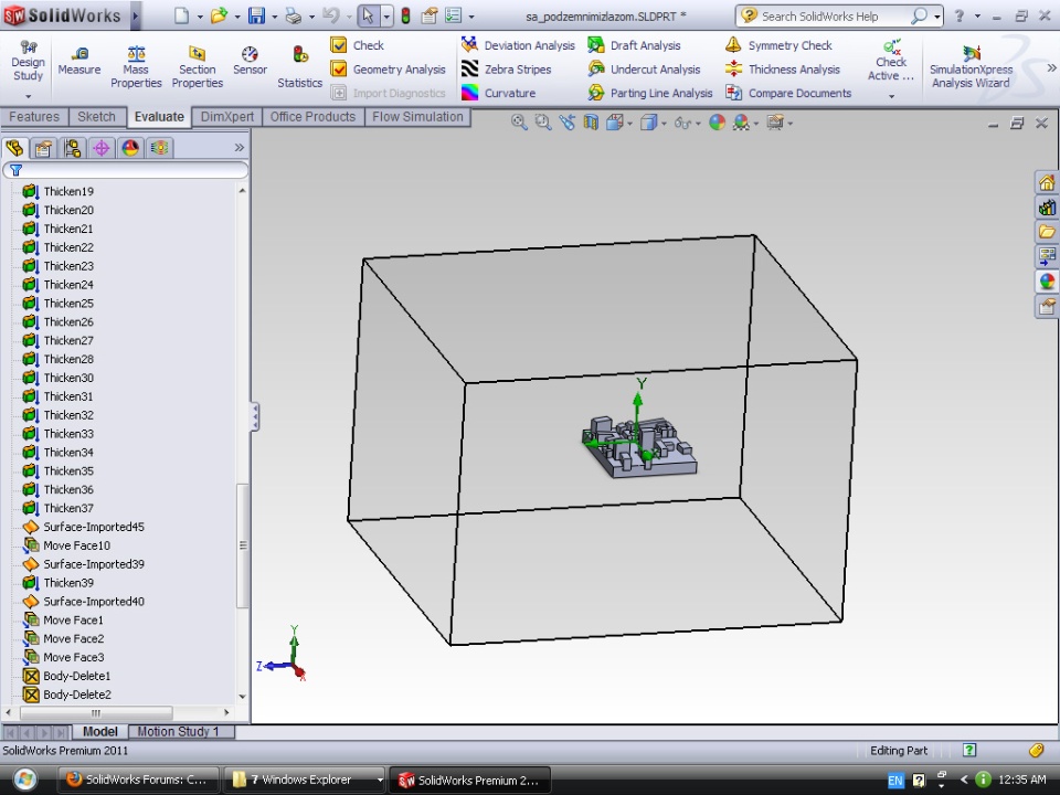

I was wondering how can I remove the green triad sign, which I automatically get when I load the Flow Simulation Add on.
I posted a similar topic, and in the end people determined that this green triad is not an Origin, nor Coordinate system nor Mass properties sign:
https://forum.solidworks.com/message/266293#266293
It only has to do with the Flow Simulation, and it appears only when I load the Flow Simulation Add on.
I was wondring if I can remove this green triad sign.

Hello,
right click on the top of the FS tree, then 'Hide Coordinate System'.
Rich.

I couldn't fix this. Where exactly is the FS tree?
Please if you could help with a screenshot asap.
Thanks Mr. Rich
BD
BD 2018-08-01
The :"FS tree" is the Flow Simulation tree on the left.  Make sure you are in the Flow tab!
