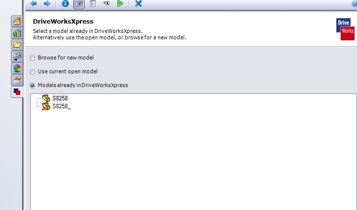

I started experimenting with DriveWorksXpress - it's really a great tool. I actually successfully set it up such that an entire part is modeled simply by entering a coded part number.
During my testing, I guess I added a second model to the Driveworks database. Now I can't find a way to remove it.
See the attached screenshot.
I launch Driveworks, click Add/Edit models, and then I am presented with what is shown in the image.
I want to delete the second from the database but have no idea how, and couldn't find an answer online.
Thanks.

SL 2014-11-27 Best Answer
The only way I found to delete a model in the Driveworks database was to open the DB in access and delete the associated records. Seemed to have worked.
Also, I later realized that moving the part files & database file sometimes broke the link between the files, and as a result, the part/dwg could not be created successfully (even though the master part/dwg were not moved in relation to one another).
I was also able to fix this by opening the DB in access and manually edit the file paths.
