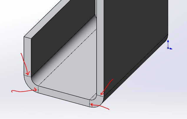

I am about to make a print for a sheet metal part I designed and I just noticed that the part has tangent edges on the sides of all of the bends.
These are unnecessary because that is all one flat surface, not separate surfaces. Is there a way to get rid of those? I want to show tangent edges on my drawing so that you can see where the bends are, but all these fake tangent edges make the drawing confusing, especially because they are so short that the tangent line font just looks like a solid line.
There is one spot on my part where those tangent lines do not show up, and I realized that is because I had done an extrude out from the side to lengthen the part, and the result did not have those lines. It was still able to flatten. Sides of bends that are exposed by a cut feature do have these tangent edges.
As I said I want tangent edges shown on the print but not these. I could show tangnet edges and then manually hide these edges, but that will be a ton of work because the actual part is fairly complicated. I could convert the real tangent edges and apply the desired line font and then hide tangent edge display, but that is also a lot of work. Delete Surface and Patch does the trick, but I'd rather not add a bunch of features if I don't have to. I feel like that would confuse someone who might need to work from my file and it could get messed up if features change.

I ended up using the Delete and Patch option. It turns out you can use one feature to delete and patch all of the bend sides at once. It might confuse someone down the road but at least it doesn't clog up the feature tree.

When I have the issue of showing some of the tangent lines but not the others I end up hiding the ones I do not want to see.
It is a little tedious but it works.

You can also RMB the drawing view and select Tangent Edge=>Tangent Edges Removed. This will not add a feature to your 3D model's Feature Tree and only that drawing view will not display the tangent edges. If you create a view from the view you turned the edge display off, that new view will also have the edge display off. There is a System setting to not show tangent edges on all new drawing views too.

Thank you. I know about those options already but I wanted tangent edges shown so that bend lines would be visible. I just didn't want the fake tangent edges on the sides of the bends to be shown.

I like using that option as well.  The only down side is that with sheetmetal parts that have bends that aren't 90 degrees, you lose the visual clue that there is a bend present.  I have requested that SolidWorks put a bend line in views that have bends that aren't 90 degrees when using the hide tangent edges option, but like many other requests, have fallen on deaf ears....
