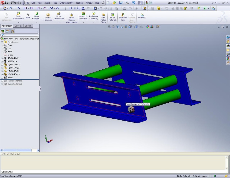

Remove "Mates" item in the FeatureManager(Feature Tree)
I am unable to rollback to any specific item in an assembly because there is a mates item at the bottom of the feature tree. The rollback bar will not go past that, making it completely worthless. How can I remove this mates item so I can rollback my model? I don't need it there considering each part has its own mate folder.

GS 2010-05-12 Best Answer
You can't drag the rollback bar past the mates list, but you can select components and suppress them to accomplish the same thing.

So if the mates item is always created, always at the bottom of your feature tree and cannot be removed, what is the point of putting in the rollback bar if it cannot go past the mates item? I don't even see why the mates item is created in the first place considering each component has it's own folder defining the mates. In my opinion the rollback bar is a helpful and standard feature that's being rendered useless by a redundant feature. We constantly used the rollbar when replacing items in an assembly while using Pro/Engineer and it worked very well. When I replace a part I don't feel that I should have to individually suppress X amount of parts to get a clear view of the component being replaced, and I cannot simply isolate that one part considering I need to see the majority of the items around it as spacial references and possibly mate re-definition. Sorry, but it just aggrevates me.
JF
JF 2010-05-20
unlike pro-e, in SW the order of the parts in the assembly tree has no meaning.  the rollback bar in an assembly only rolls back through the assembly level features - which are added below the mates folder. you can directly drag parts up and down the tree to re-order them. there is also the "replace component" comand you may want to try out.
