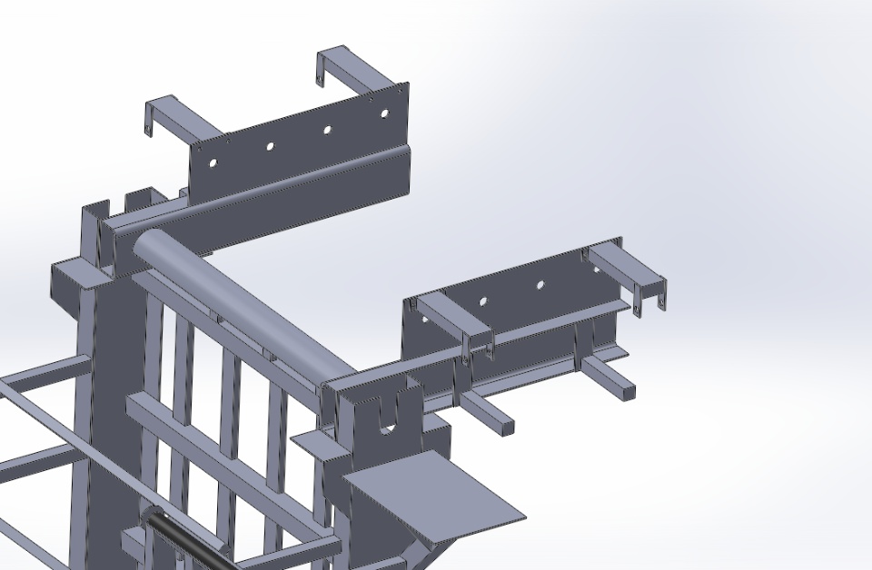

Is it possible to remove some features of a part that are created together and change them into an assmbly? Or would you have to just recreate the pieces again. I am attaching the file. I am trying to remove the two arms sticking out that would be fitted with hydraulic pipes, they are concentric with an axis going across so I would like to make them spin with the axis when I turn it but I created them in the frame part file instead of an assembly and inserted it later... get my drift?

Use the Split tool to create a multibody part, then save the bodies out as separate parts while using the Create Assembly option.
http://help.solidworks.com/2013/English/solidworks/sldworks/c_splitting_parts_and_saving_bodies.htm

Every time I go to save the file this is what shows up. I picked the faces which I was to trim from, then cut the part, selected the bodies, and double clicked the name to save it. Am I doing something wrong? I have tried different names and it won't let me pick a format so I am hitting a wall. Thanks in advance

Complete the Split operation first, and then right-click on the Solid Bodies folder to do the Save as.

I didn't open your part, so Kelvin's advice may be the best method, but you might be able to create your parts more easily by rolling back in your feature tree, selecting the first feature in the arm and editing it, deleting the check mark next to "Merge result". Now you will have a separate body from the start. This may break some of the later features, so you will have to go in and change the "Feature Scope" to merge the new features with the correct body or bodies. At the end save the solid bodies as parts.
