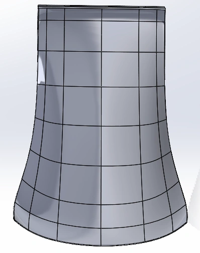

I have imported a step file to Solidworks 2023. It looks like this.
I want to cnc it via JLCCNC, but got the response:
The uploaded drawings contains broken surfaces, which makes it unprocessable on our end. We kindly ask you to revise the file on your side to ensure the surfaces are properly closed. [...] On your drawing, there are many lines, which makes it difficult to machine all the details properly, resulting in what we referred to as “broken surfaces.”

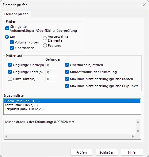

Check
  1. Surface - Minimum radius = 0.997 mm
  2. Maximum gap between edges: 0.00390915 mm
  3. Maximum gap between corner points: 0.00390915 mm
Seems not to be the problem for these "many lines", JLC was talking about.

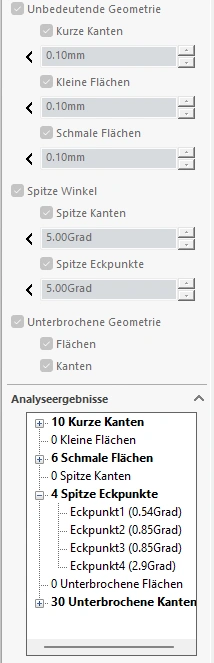

Geometry Analysis
Show many problems, but no way to fix them?

So does anyone have a clue what my problem is and how to solve it easily? I have 4 different models with similar problems and I do not want to spend hours on each model to fix each line individually...

Using your furnished sample:
  1. 3D sketch and Fit Spline for each U/V edge and for each perimeter edge (turning on the Edge filter helps the selection)
    When done, hide the imported body for easier selection in the next step
  2. Start a Boundary Surface (for your whole model, so other equal command may be required instead)
    For Direction 1, select each Fit Spline in the U direction (as an open group)
    For Direction 2, select the splines in the V direction (whether the U splines are in Direction 1 or 2 doesn't matter)
    I colored my boundary surface red, then hid it
  3. Show the import body and using Delete Face, delete (without patching) the top faces comprising the grid
  4. Show the boundary surface and Knit Surface it to the imported body, being sure to check create solid
