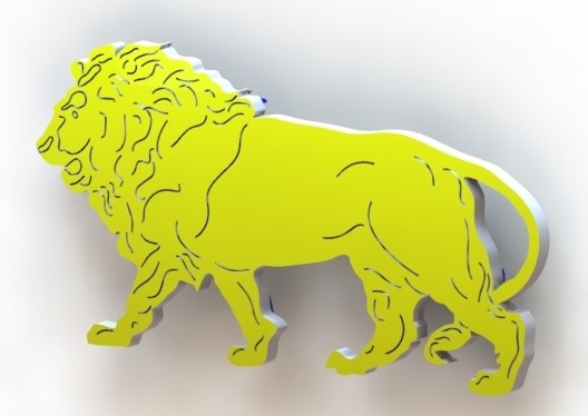

ZSurf4 (free) can create an igs surface from a greyscale bitmap.
http://www.cadstudio.cz/dl_file.asp?ID=1129
You usually have to spend some time modifying the image, since you really want a heightmap and most photos don't work all that well.
I took your image and modified it. Try this in ZSurf:
comment imagecomment image

OK, here's a SW file with a curved and a flat version. You can set the curvature in ZSurf
I also included the IGS files from ZSurf and the BMP is used in ZSurf

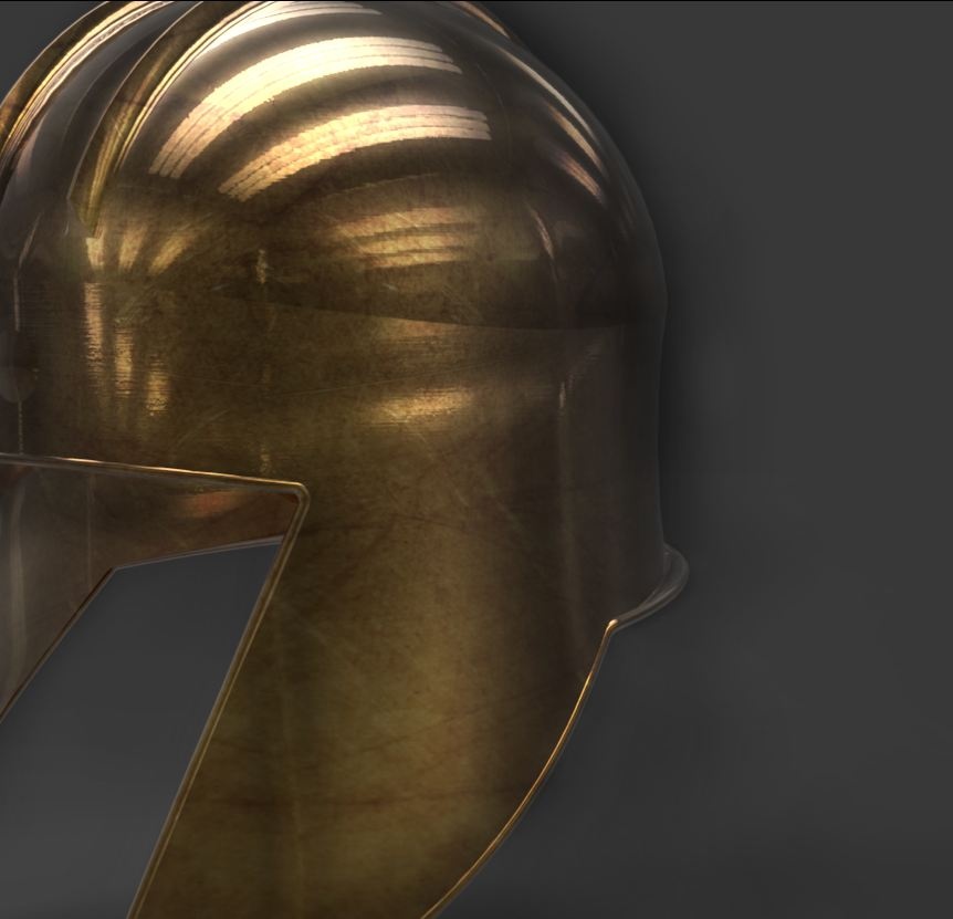

I will try this to render with the helmet I will show preview here how it came out. this is test render of full helmet two lions will go right in forehead. I went and got Zbrush so hopeful I will get a better quality mesh when I do a image based embos if I can figure it out
