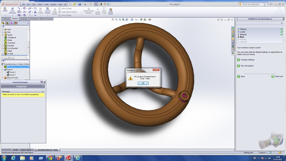

while working on simulation xpress i'm getting error as HW_Analysis:Simulation Xpress Study :Failed
Does this happen on a simple block? Make sure the file is saved to your desktop.
If so, probably an install issue. Or potentially an imcompatibiity with your system.
Can you let us know what version and service pack of solidworks you are using? How did you install? Were av and as tools disabled?
What version of windows and what variant are you running?
