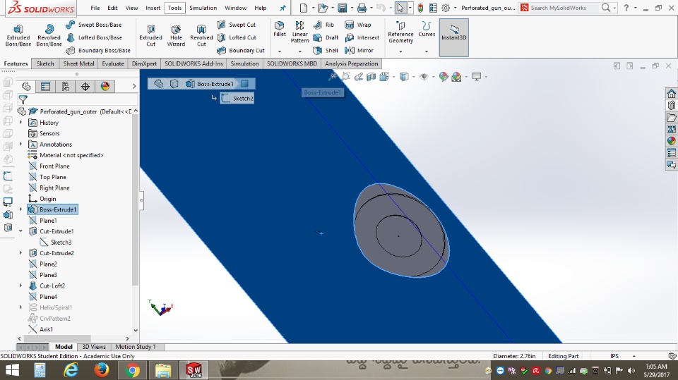

Hi all,
I am very tired of searching for a pattern tool which can be used for linear and angular in a single time i.e, one or more features to be linearly moved at some other angle on a curved face (like cylinder, sphere etc.).  Please provide with some example solutions at the earliest.
I need this feature to be patterned linearly but at different angle.  I have done using curve driven pattern but the exact dimension has not been achieved.  So, please provide with some exclusive examples.

Hi Ranjith,
Something like this?
if not can you post a rough sketch of what you want to achieve?
comment imagecomment image

HI Sachin Malenahalli Murigesh,
Thanks  for your answer....!!
I have got a solution in that way but the dimensions(locations of deboss) are mis-matching as per the model I have.  So, I have to edit the dimensions linearly and angularly without using helix .  Please provide solution for this issue.
Thanks
