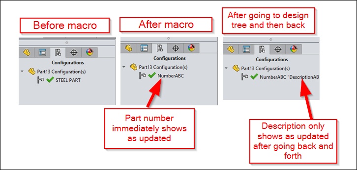

I am working on doing some work updating properties and am unable to determine a way to refresh the UI so that the changes I make display right away.  For the below example, I change the configuration name to "NumberABC" and the configuration description to "DescriptionABC".  The display for the number updates immediately however the description doesn't show until I cycle back and forth to the design tree tab.  I've tried using EnableGraphicsUpdate, GraphicsRedraw2, and ForceRebuildAll without noticing a change in behavior.  I also have a similar problem when updating the custom properties of the configuration.
