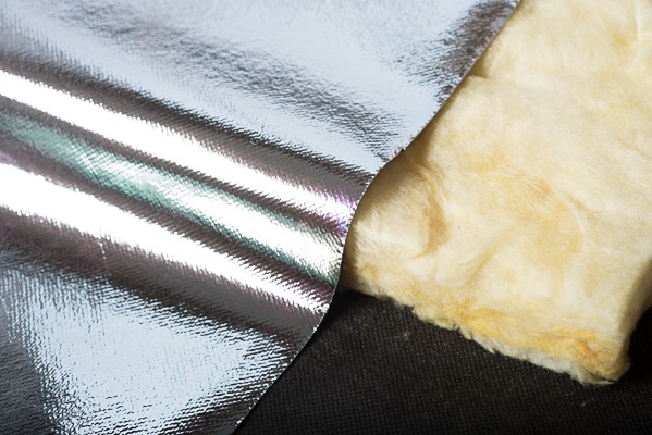

Greetings all,
I'm trying to render a model so that the material looks the same as the one in attached pictures, I am not getting good results.  I am not very good with Photoview - all I have tried so far is the default materials in Solidworks that are reflective or have texture such as chrome, knurled steel, cast chrome etc (I have played about with mapping and reflectivity to no avail).  I have also tried some of the appearances/materials from the Luxology site but haven't had much luck with that either.
I have no tried adding lights or cameras yet.  Any thoughts, hints and suggestions would be great.  Model is attached.

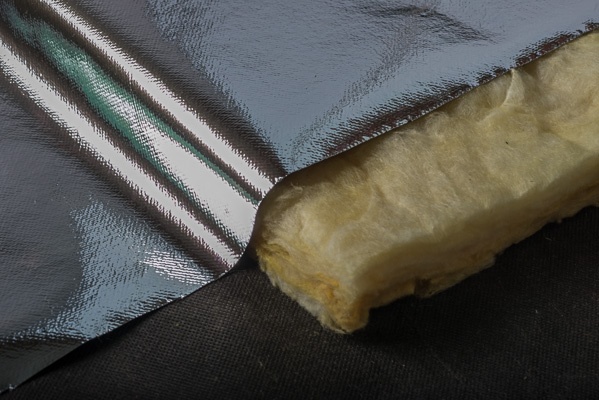

Good morning Dave,
Would something like this help you out? You will have to play around with the settings a bit and choose the right environment of course.

I did a quick search on Google for foil texture and found this image that seems to be fairly seamless. I am attaching the jpeg and SW texture, and I am also attaching one that I added a bit of blue tint to. Please review my attachment to add a jpeg as a texture.

I've updated the SW texture for you. Try using Soft Box environment in your render and adjust your brightness and reflection amount to your liking. Play around with different environments until you find the one that suites your model.
