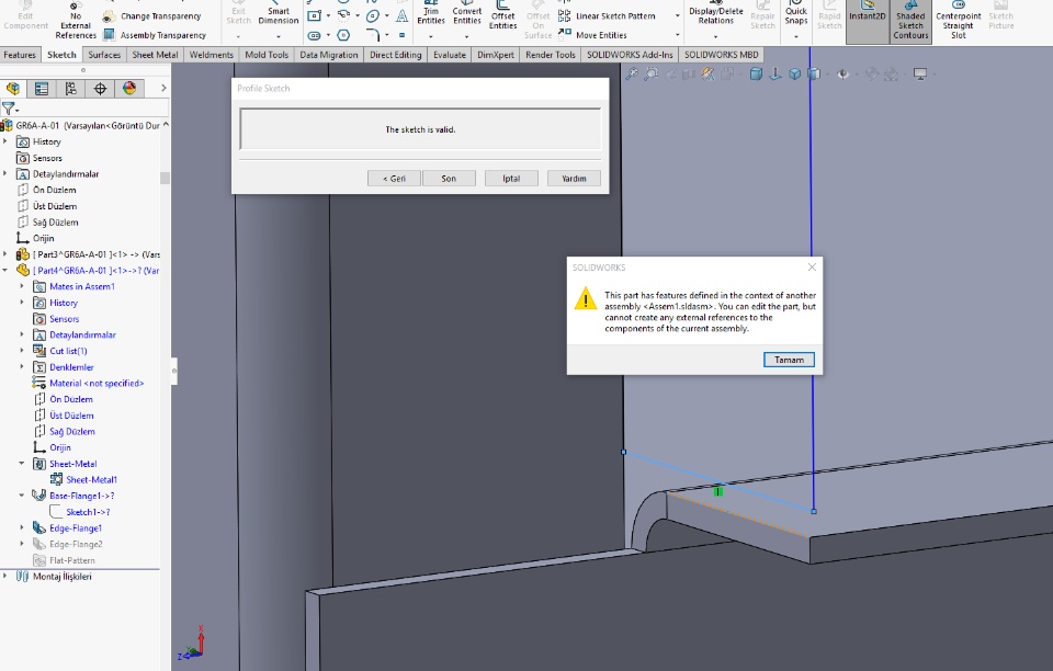

Sometimes the parts are not a reference to each other. In the assembly environment.
What is the cause of this error?
For example.
I can't link the collinear two lines.
For example.
Ahmet
To avoid SolidWorks creating a circular reference, in an assembly environment you can only reference sketch geometry from one assy. If you were allowed to reference from two then the assy would fight against each other.
what i think has happened here is you created an assembly, created your in context references and then saved the Assembly. So the incontext links are referring to the unsaved name of the Assy (Assem1) to which you change with the first save.
it is best to create the assembly, save it, and then start your incontext modelling. then use SolidWorks Explorer if you need to rename things
If you insist on making external references from more than one assembly it is indeed possible. You have to set this option:
But it might cost you on performance, transparency of design intend and difficult file handling.
