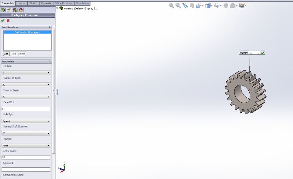

How can I reconfigure toolbox component? When I add new component form toolbox to assembly I can configure (teeth, size etc) then I press OK. But I want to change some parameter I need add new component, because I cannot edit. I hope you understood me

You should be able to right click the toolbox part and select "edit toolbox component." This should allow you to change your parameters.

Check your add-ins menu, your sw toolbox browers and sw toolbox add-ins may be unchecked. If they are, recheck all for boxes and re-open your assembly you should have the option  when right clicking on a toolbox component, to "edit toolbox component".
I have tested this out and can verifiy that the toolbox add-ins must be active to have the option to edit the components.
If you are trying to add a part that is unassigned just click add and type your description in the Description box and solidworks will add it to your toolbox.
If you are trying to add a new configuration you need to use the toolbox settings program under START>Solidworks20xx>Solidworks Tools>Toolbox Settings
You can also access it under Toolbox>configure (in soildworks).
If you need a login see your admin otherwise your changes will not be saved.
