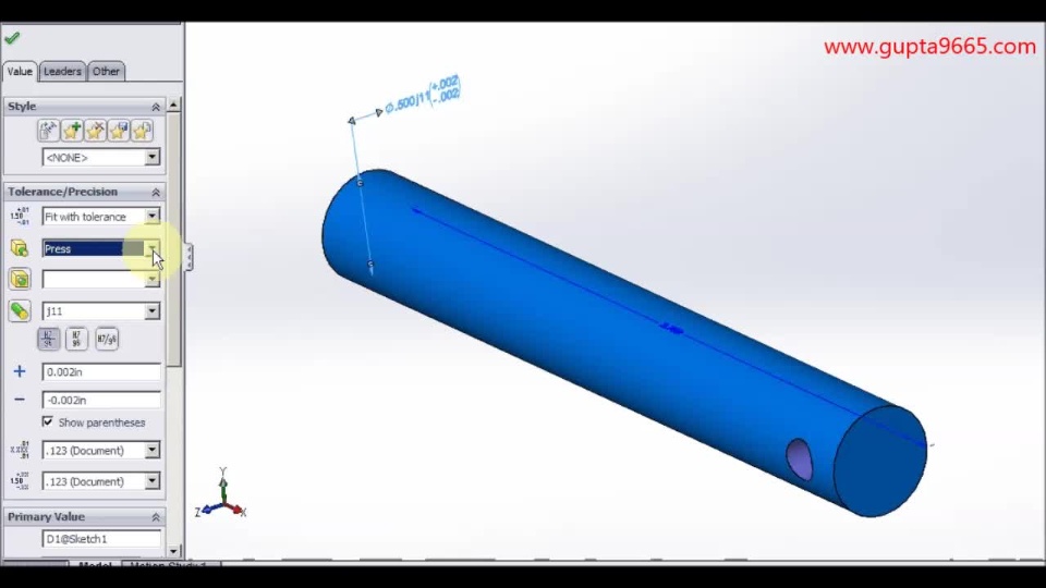

DG 2013-10-31
Because of a different language (other than English) I could not understand clearly but check the attached video, I'm sure this is what you looking for. Let me know if you meant something different.
