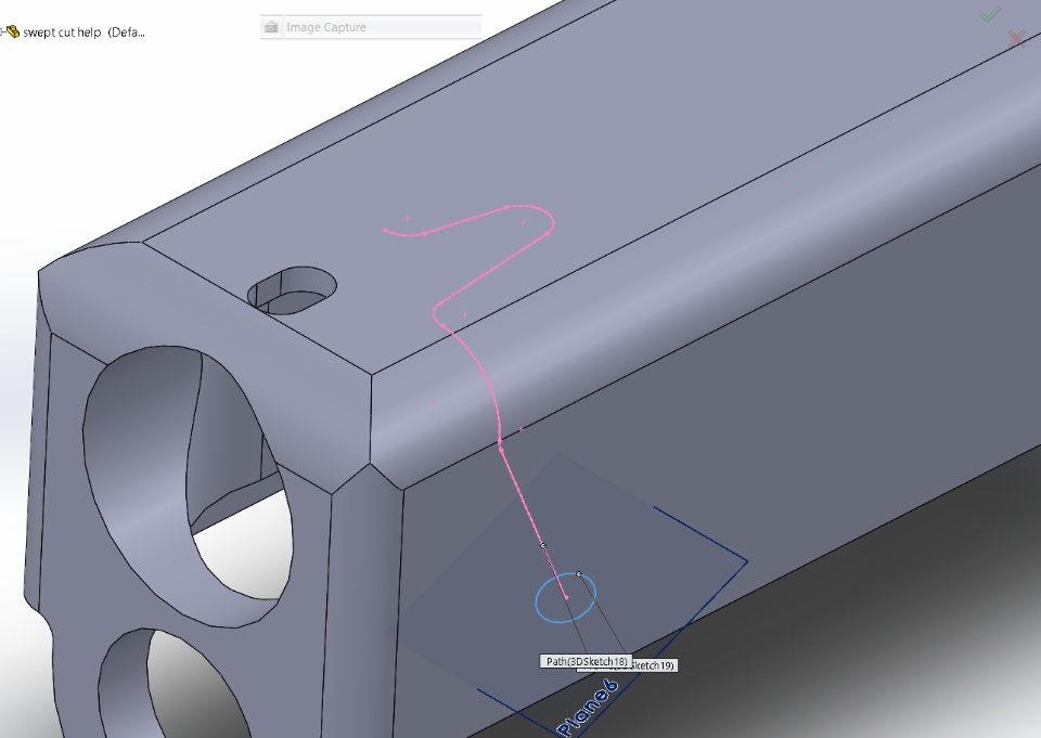

Rebuild Error: Sweep resulted in topologically invalid body. How can I determine what part of the sweep path is causing this error?
Trying to cut a semi-circular groove along the 3d sketch running across the model. I have remodeled the path several times very carefully trying different radius (currently .0625"). At this point I'm just at a loss to see what is causing the problem.

Hi Brett,
The problem here is with self-intersection of the resultant profile geometry. The circular profile you are using in your model is having a radius of 0.0625 and the swept profile also having same radius along the path at couple of places (as shown below) where the resultant profile preview geometry is getting self-intersected.
In order to complete your model with the given path you have to create multiple sweep feature using different profiles along the path in order to get the
required sweep cut.
Attached screenshot and model represents the way how we can achieve this sweep cut.
-Ravi
