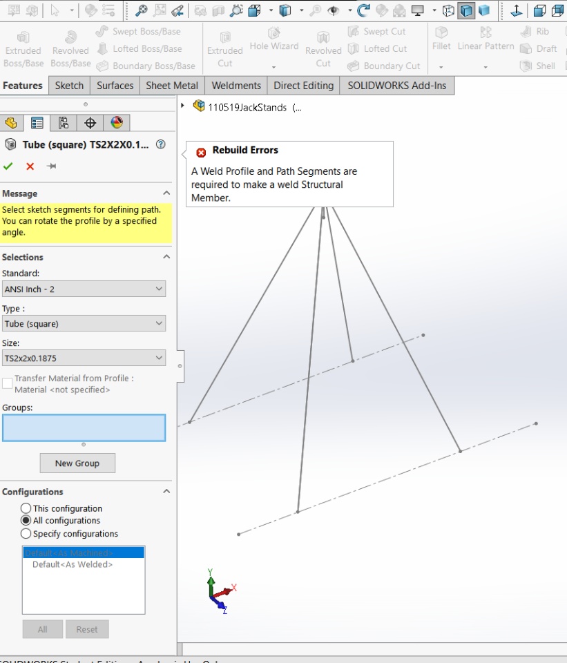

Rebuild error message
I'm getting the "Rebuild Error" message as I'm trying to "check" out of this part of the weldment model. I'd like to get back to the sketch it self to make changes. But first I'm assuming I have to delete the structual members from the model ?
What am I doing wrong and what do I need to do to get around this message ?

There are no segments selected to make into structural elements.  Just hit X and cancel the feature.

ok but if you look at the image I posted, you see the group box was empty. then if I chose either green chek or red x I got the same error messge as showed. So I'm not sure what the problem was but it may have been a software glitch.

You simply cannot leave the box empty.....Its not allowed.   Never leave the box empty.  In almost any command inside Solidworks, if you leave the blue selection box empty, and then try to hit the green check, it will give you a similar error.   You cannot have an empty feature.

That's what I kept doing Dan. I kept deleting the group leaving the box empty then checking or Xing out. Either way I was stuck. But I'm not sure what the problem was. I'm out of it now.

Sorry, I found the problem. I deleted the entire feature from the feature tree. When I was in the feature, if I x'ed out, I was left with one group left. I'm a beginner as you can guess I guess ?

I'll take a stab at this.  It's my impression that you're trying to exit out of the Structural Member function so you can edit the sketch.  If that's correct then please do the following:
  1. Click the little red X beside the green check mark at the top of the feature's property manager.  As has been saying, that will close out the feature.
  2. Click on the sketch.
  3. Choose the "Edit Sketch" icon.
  4. Edit the sketch as desired.
  5. Close the sketch.
  6. Start over with the Structural Member feature.

This box is empty.   You cannot hit the green check while the box (with the big red arrow pointing to it) is empty.
If you hit the red X instead of the green check, then you can exit the command without changing anything.
Then you can go back and select the feature and hit the delete key to delete it completely.
It won't allow the feature to be there if there is no group inside of it.  So it really looks like you want to delete the feature.

A weldment feature CANNOT HAVE ZERO GROUPS.  You cannot have a weldment feature that creates zero weld bodies.  You have tried to edit the feature and delete all the bodies.  That doesn't work.  You have to stop editing the feature.  Use the X button.  Not the check button.  See the button that looks like an X?  That is the X button.  Click it.  Your model will rebuild, and there will be some structurall members.  That's OK.  You can then DELETE THE ENTIRE FEATURE.  Don't worry, your precious 3D sketch will still be there.  You can edit it.  Then you can create a new structural member feature.

Wrong. You still don't understand. Here is another example of text base communication failure. I've deleted the group. I'm not trying to X "CHECK OK" to complete the deletion. ITs not accepting the operation.

I'm not adding structural members. I'm attempting to delete them all and get back to a bear sketch. But I'm getting this message that is blocking me from "CHECKING"  OK.
Then hit X to cancel your current editing operation, then delete the dang feature. Feature cannot have zero selections for members.
